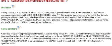

Code 15. Pass circuit initiator resistance high. What would that be? I assume a sensor of some sort, in the passenger seat, as the SRS light is on.

Code 15 indicates a faulty coolant temperature sensor, nothing to do with the restraint system. You need a special scan tool to retrieve the SRS trouble codes.

Thanks for the info bluelightnin6. We were using a scan tool and it came up with the error code 15. Pass initiator circuit resistance high. We were scanning for the SRS error code at the time. I did not personally run the scanner, but the person who was using it, I am pretty comfortable with his knowledge of how to use it correctly. I had done a little searching and found the error code 15 has something to do with the coolant system, so now I am baffled. Will have to go back and re-read the code and see if I missed something! Thanks again!

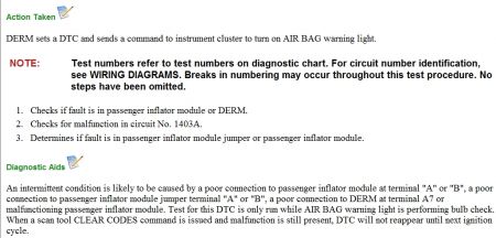

Ok i see , its code 15 of the SRS not code 15 of the engine. some information is below on the SRS code 15..
