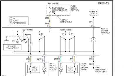

1995 Chevy Cavalier 4 cyl Automatic 65000 miles
My electric car windows don't work. They stopped working intermintedly.

Hi, check for voltage at the power window circuit breaker. The circuit goes hot, when you turn on the key. If that checks out, I'd have to check the circuits at the master switch. What I looked at, was the two door version.
https://images.2carpros.com/forum/automotive_pictures/170934_cavalier_two_door_version_1.jpg
