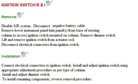

How to remove the ignition switch and seperate the key tumbler

Jun 27, 2010 at 3:51 PM
