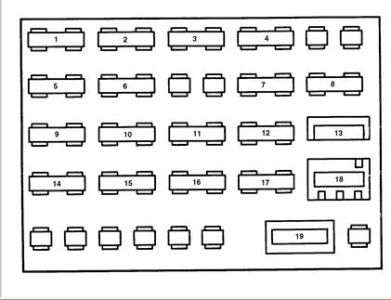

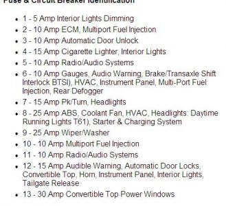

Hi, there maybe a doorlock circuit breaker in the fuse box. Pull the breaker, see if problem goes away? The courtesy fuse serves many circuits, I'd have to isolate the circuits one at a time, slow process. I found a picture of fuse box and fuse ID. Try pulling the doorlock circuit breaker. And test again.

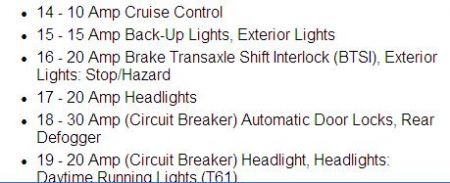

When I pulled the courtesy "fuse" the light went out and stopping dome light, horn, power locks, audible warning system and check oil light (I guess) from working. I still have the auto door lock/unlock unplugged from the harness, hoping that was the culprit.
I did, a a while back pull the (breaker) "ACC" marked #18 on your chart. I thought it worked as it started the next morning but day 2?? No go. This "breaker" controls power locks and rear window defogger.

Hi, is it fuse number 12, that you pulled? Pulling that fuse killed the drain? I'd have to disconnect every circuit, one at a time, that the fuse serves, to narrow it down. Sorry it took so long to answer back. I get wrapped-up sometimes.
Jan 22, 2010 at 7:38 AM
GARYD409
  • 10 POSTS
Yes sir, it was the #12 fuse that I pulled. 4th row from left and 3rd from the top. Courtesy fuse. It controls interior lights (dome), horn, power locks, audible warning system, remote lift gate release. (I have the pull type on left of driver's seat) and check oil light. Mine shows (Check engine). It has not come on since I have disconnected the fuse whereas it came on and stayed on periodically before the fuse was removed. Presently, I have "of course" the fuse pulled. I have disconnected the power door locks at harness behind switch on doors, removed the dome light bulb, trunk light bulb, checked for lights on at night time. All I can see left is the audible warning system or the horn!? Gotta admit brother, I am lost!! Can a (breaker) it's self go bad???? Thank you again my brother and God Bless you and ALL at 2 car pros. I am having to file bankruptcy at the time but rest assured when it is said and done, you folks will get a good donation and will always save your site and tell all I know about you!!! IN HIS GRIP IBNJC Gary / Son Shine Ministries

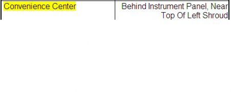

My info shows junction splices, doesn't show the location. You can follow the orange wire to the junction, take each leg loose, one at at time, till you kill the drain. Then the problem is on that leg. For me, trying to find the problem is hunt and peck, at this point. Wish I had a faster way. There is an alarm module in the convenience center, under left side of dash. Probably more than one relay or module, right now, I don't know which is which. Any lites on that fuse circuit that are controlled by the headlamp switch, you might unplug the headlamp swich.
https://images.2carpros.com/forum/automotive_pictures/170934_convenience_center_1.jpg
With everything turned off, there will be some normal drain, checking the amp draw is the best way. Anything in your vehicle that uses memory has to have some voltage, even with everything turned off. radio--clock-- pcm-- whatever uses memory.
