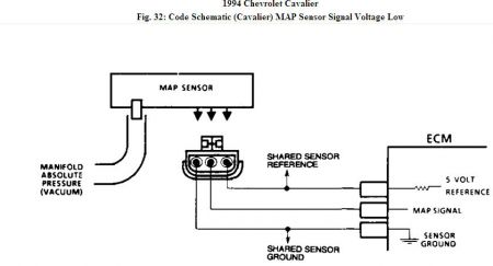

my car is revving very high like the thorttle is stuck and then it will start to idle up and down with the check engine light on replaceed the map sensor and thorttle postiosn sensor still didnt fix it?

i live in the valley of oregon so doesnt get to cold here the local parts store scanner said low map pressure?

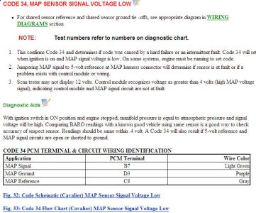

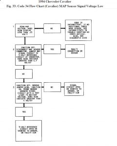

TPS voltage is .6V t0 4.80 V.
I don't know what code number you have so I assume it is this:
https://www.2carpros.com/forum/automotive_pictures/30961_acav3_1.jpg
https://www.2carpros.com/forum/automotive_pictures/30961_acav1_1.jpg
https://www.2carpros.com/forum/automotive_pictures/30961_acav2_1.jpg
If this is the right code and you can't read this, send me an email.
Pukenstein@aol.com
and I'll send it.

The two things I would focus on at this point...actually 3.
1-Be sure the wires and connections are good at the iac, map and pcm. Be sure the harnesses have not been damaged through heat or oil and no corrosion exists.
2-be sure there are no vauum leaks. At the manifold and all rubber goods. Look for any dry rotted, collapsed or opened up lines.
3- Clean the throttle bore with a good cleaner. May need to pick up a bottle brush to aid in this.
https://www.2carpros.com/how_to/how_to_tune_up.htm
Saturday, August 1st, 2009 AT 5:44 AM
SERVICE WRITER
  • 9,123 POSTS
In an email, the member found the intake manifold leaking. The unmetered air was the vacuum leak.
