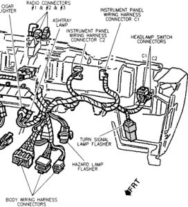

I have a 1993 Chevy Cavalier RS, and I would like to know what could be the problem with my turn signals even after I replaced the turn signal switch, and the fuses, and it will still not work at all, even though the hazard flashers work the turn signals won't?

You have two Flasher's, One for turn signals and one for Hazards. I suspect your turn signal flasher is not working. Location: Front seating area, driverside, under dash, mounted on passenger side of steering column
