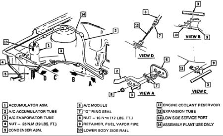

Where does the orifice tube attach on the a/c. To the dryer or the compressor?
Thursday, August 12th, 2010 AT 7:09 PM
MECHANIC
75,992 POSTS
Evaporator Tube & Accumulator Tube
Expansion (Orifice) Tube
The Expansion (Orifice) Tube is located at the condenser to evaporator tube connection in the evaporator tube.
