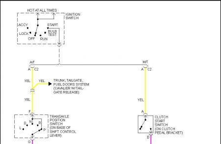

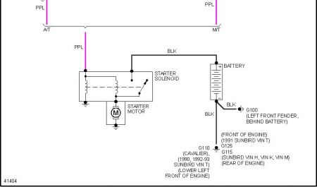

i need to rewire the ignition. I have the manual, but it is very vague. I need to know the color code and if I can find a detailed wiring diagram somewhere. I have one wire left after rewiring to an ignition switch. No clue where it goes. Any ideas?
