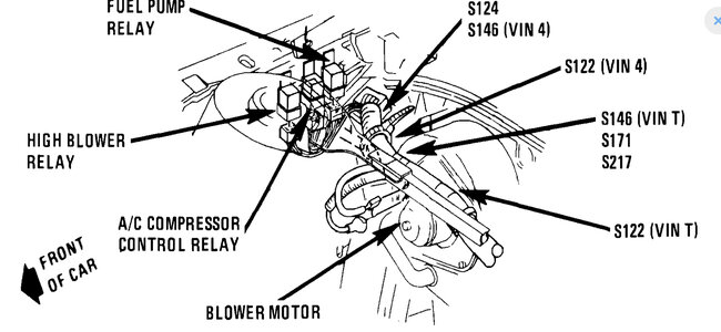

hi guys. i have a 1992 chevy cavalier and my fuel pump is not cutting on. i dont know where the fuel pump relay is can you please tell me where i can find the fuel pump relay?

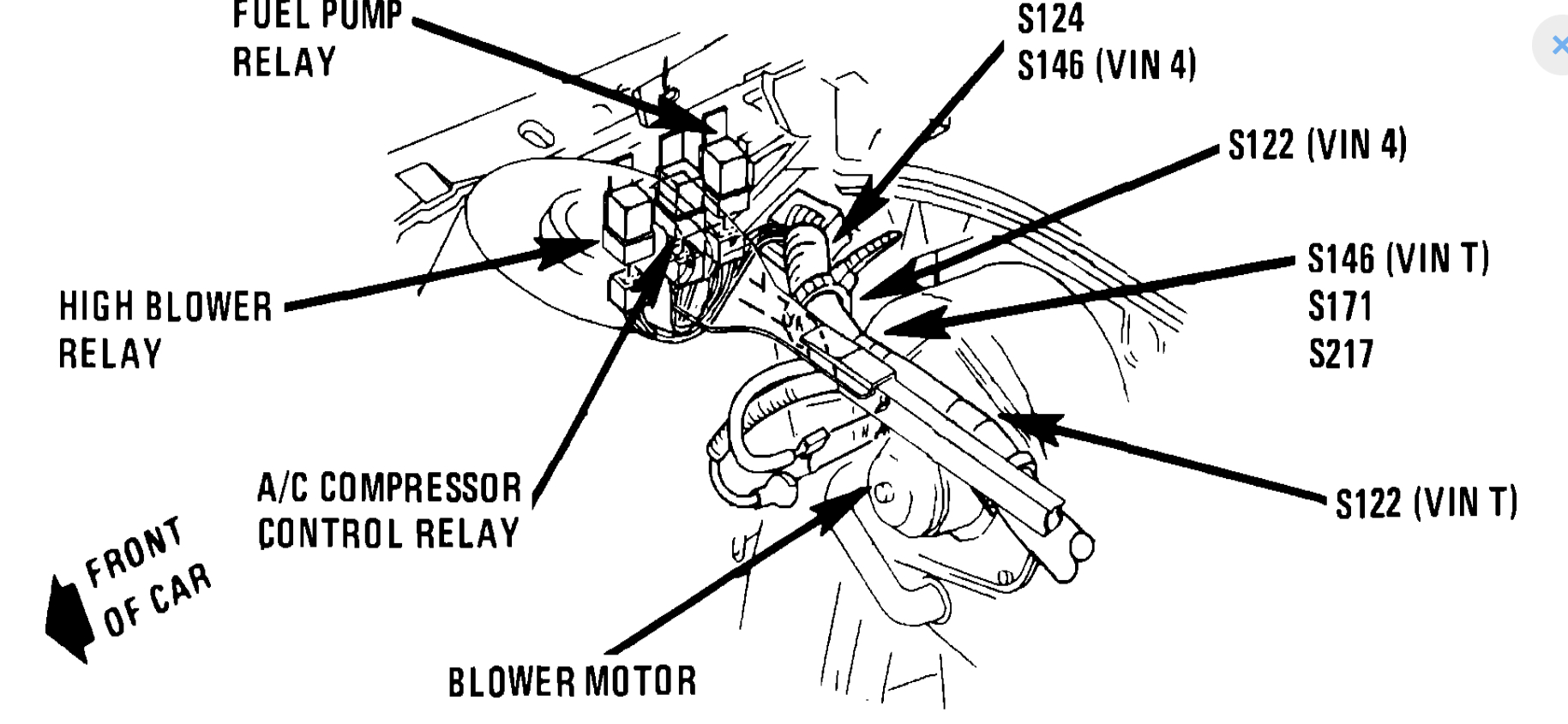

The fuel pump relay is located behind the L/F strut tower. Item No 3 I hope this helps, Mark (mhpautos) Check out the images (below). Let us know if you need anything else.
