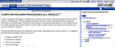

Hey Guys-- My IAC motor needs to be replaced on my car and I just recently heard that after replacement I would need to "reset" the idle. Is this possible, if so how?

See computer relearning procedures below unable to reset it by doing the relearning procedures -You need a Tech1 scantool
https://www.2carpros.com/forum/automotive_pictures/12900_relearning1_1.jpg
https://www.2carpros.com/forum/automotive_pictures/12900_relearning2_1.jpg
