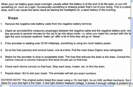

Could be a short in the ignition switch that's draining the battery
https://images.2carpros.com/forum/automotive_pictures/12900_parastic_draw_1_187.jpg
