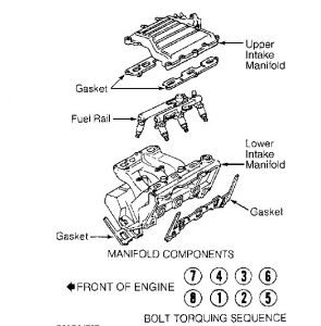

Engine Mechanical problem
1991 Chevy Cavalier 6 cyl Front Wheel Drive Automatic
I need the tourq and order to tourq the rocer arms and intake manafold bolts
Jul 13, 2008 at 12:24 AM
SERVICE WRITER
  • 9,123 POSTS
Intake manifold: First step to 15 ft lbs, then second pass at 24 ft lbs.
https://images.2carpros.com/forum/automotive_pictures/30961_cav_2.jpg
Rocker nut: 18 ft lbs Rocker stud: 47 ft lbs
