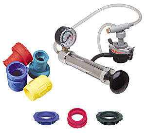

Anitfreeze is leaking have new thermastate and there is no torn is the hoses. Still runs but will get hot after awhile

You need to pressure test the cooling system to locate the leak.

How do I check the pressure

You use a cooling system pressure tester. Some of the parts stores will rent or loan them.
