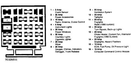

Where is the fuse for the fuel pump located

Fuse number 15..Check out the diagrams (Below). Please let us know if you need anything else to get the problem fixed.
