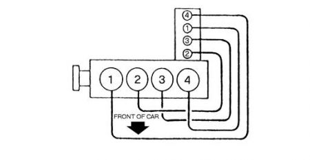

What is the firing order on the coil pack?

https://images.2carpros.com/forum/automotive_pictures/170934_chevy_cavalier_2.jpg
