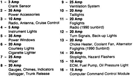

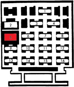

do I need a relay? why do all the windows not work?
