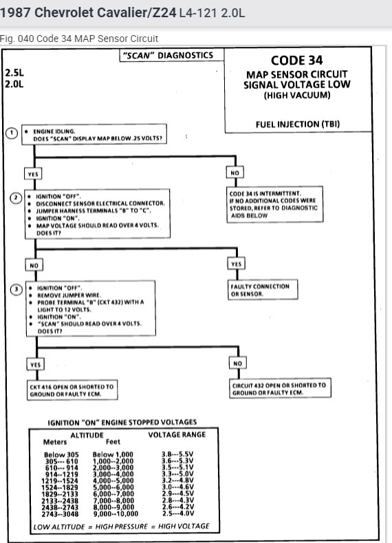

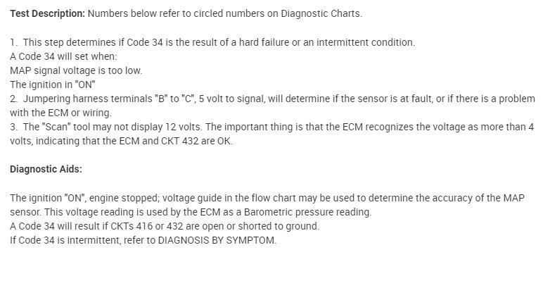

car MIL comes on when coasting and then stalls when pushing in clutch. If I pop the clutch, or hit the key, it will start right back up and run fine. The MIL then goes off. After coasting again, the problem repeats itself. The car will again restart right away. Used the paperclip trick to retrieve codes. I got codes 34 and 35. Any help appreciated!

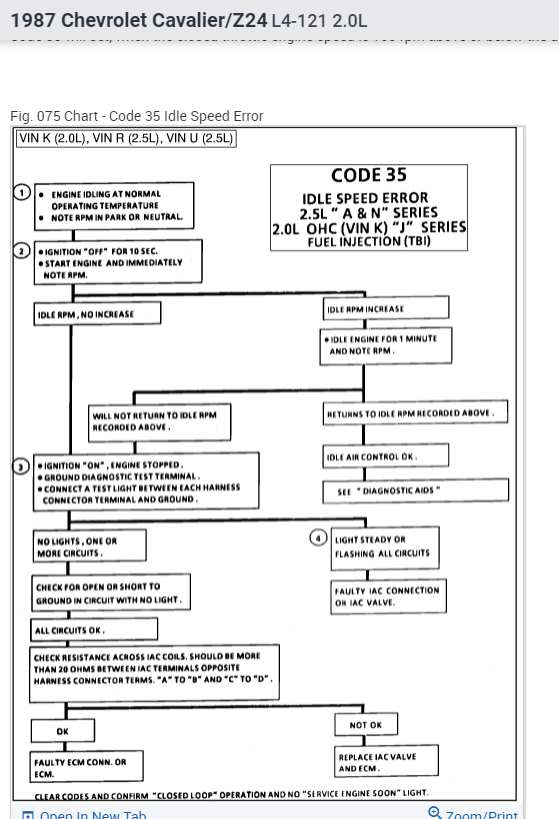

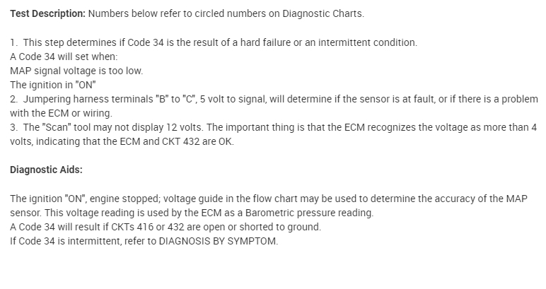

The code:

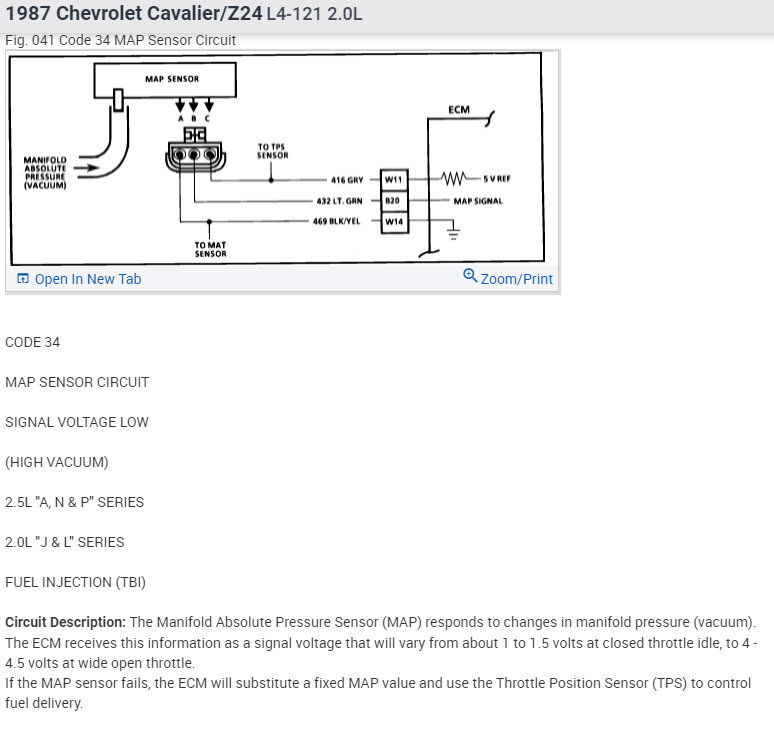

34- Map sensor signal out of range, low

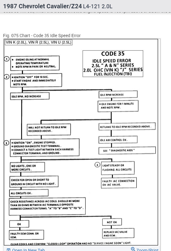

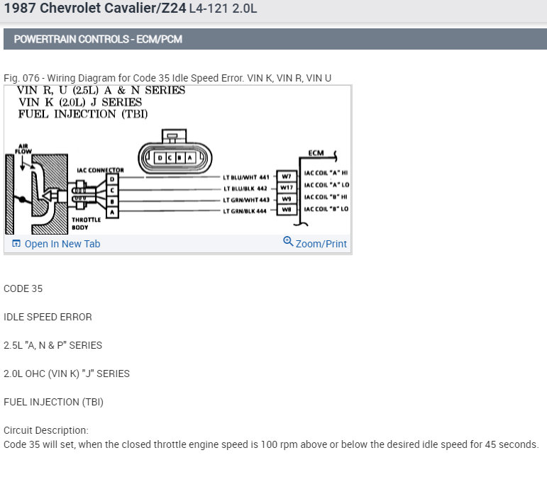

35- Idle air control sensor circuit fault
https://www.2carpros.com/articles/buick-cadillac-chevy-gmc-oldsmobile-pontiac-gm-1983-1995-obd1-code-definitions-and-retrieval-method

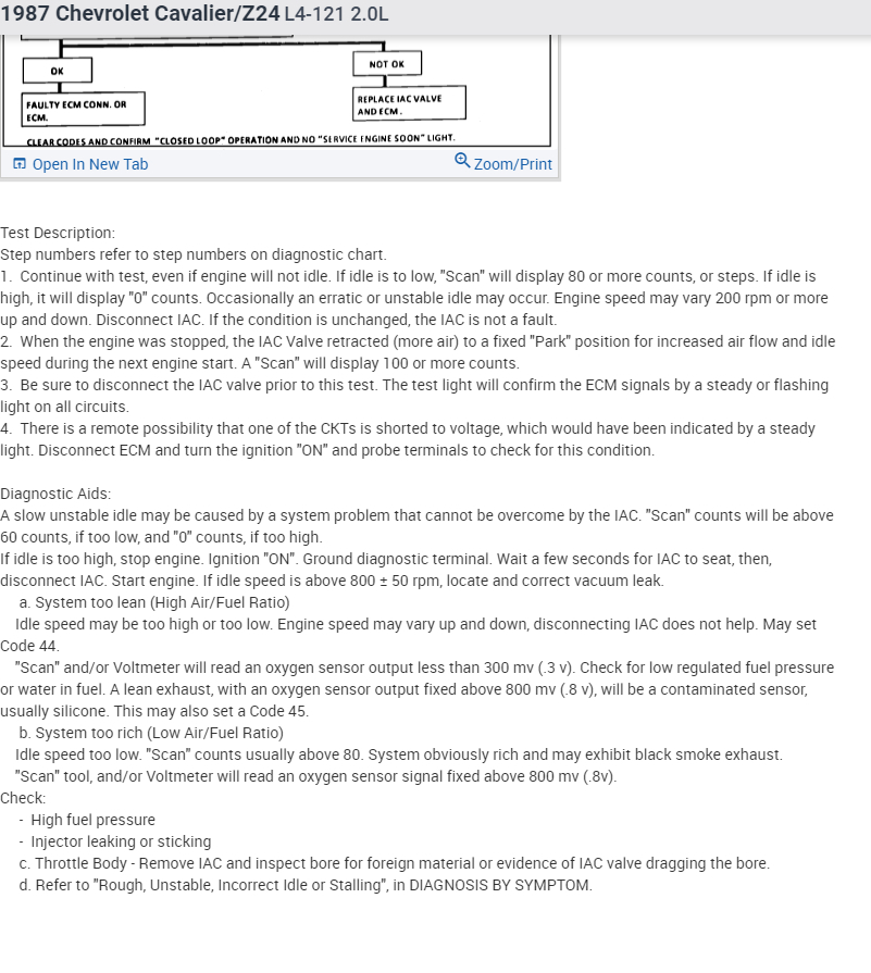

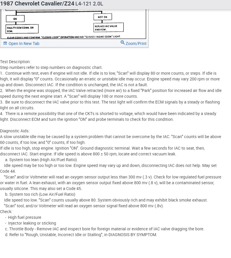

These can be triggered due to several factors. Wiring issue, faulty sensor or bad ECM.
I have attached the step-by-step trouble shooting guide for these (look below).
Follow those steps, which will help determining the issue.
