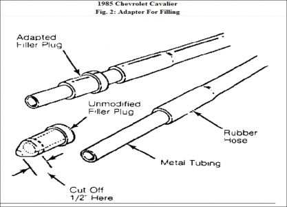

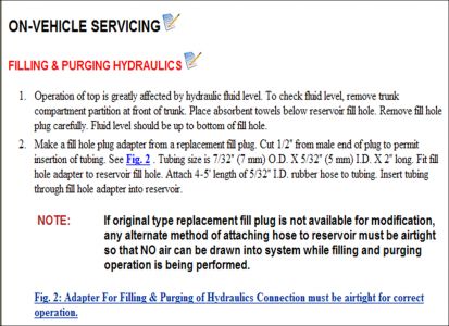

The convertible top motor appears to be new, and it runs when the top switch is pressed, but the top dosent move. I have allways been able to find a hydraulic fill fluid filler hole on previous convertibles, but is ther one for this car? I am not famillar with this modle, and the local parts store has nothing on convertible top operation. Help!

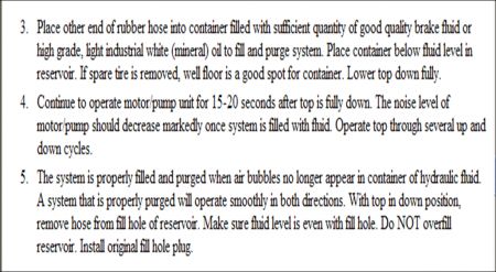

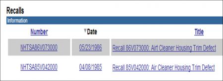

Hello - Since you didn't specify on the model, I went with just the Cavalier. The other choices were CS and Type-10. I have attached the information on filling the pumps per your request. Also, you may have some recalls on your vehicle. The dealer may fix these for free. Please contact the dealer service department, give them the VIN number of your car and have them check on these to see if they apply to you.
