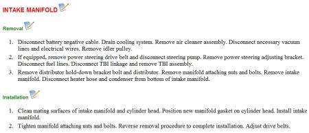

how do you replace intake manifold gasket?
Sep 2, 2010 at 6:27 AM
BLUELIGHTNIN6
Experienced Mechanic
16,542 POSTS
Sep 3, 2010 at 2:41 PM
