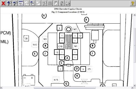

  • 75,988 POSTS
The coolant temperature sensor is what I changed if located on the water pump on 1994 Chevy Caprice. And the thermostat was changed two months ago along with the water pump.[/quote:12b151855a] The engine coolant temperature sensor is located on front of engine near thermostat housing @ D and the coolant temperature sending unit to guage is @ N5-see below
https://images.2carpros.com/forum/automotive_pictures/12900_cts_2.jpg
