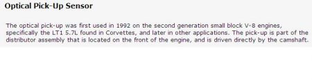

It looks like opti-spark ignition system. If the issue is intermittent, testing when everything is good, won't show anything. Testing has to be done, when the problem is ongoing. A good shop probably can't find anything unless the vehicle is acting-up, when tested.

What the heck is Opti-Spark ignition. I've never heard of that one. Of course I'm more old school, points, HEI, then straight to coil packs on the LS series and my HEMI. Is that similar to the system that I've seen on Grand Nats, with a little black box that all the plug wires come off of?

  • 16,098 POSTS
https://images.2carpros.com/forum/automotive_pictures/170934_optical_sensor_1.jpg
https://images.2carpros.com/forum/automotive_pictures/170934_optispark_distributor_1.jpg
