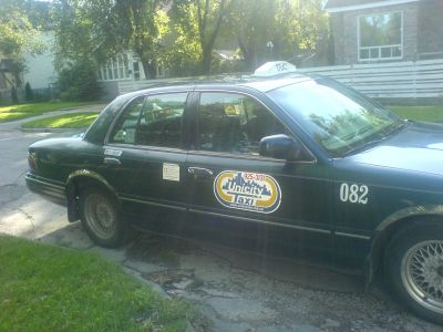

my interior lights didn't come on when i opened the car door.I have no heat no radio no turn signals and no tail lights. i do have brake lights,and also headlights. the only thing that happened today,i purchased a tv and they loaded it in the truck. they really put it all the way back in the trunk.i noticed some wiring hooked up back there. would that have any thing to do with it,a short perhaps.the power windows work. and the door locks[img:4cfef8fbba]http://www.2carpros.com/forum/automotive_pictures/587391_cab_82_1.jpg[/img:4cfef8fbba]

I couldn't find wiring info for a 98 caprice? Found a 96 caprice?
Check the applicable fuses, not only check the fuse, use a voltage tester, make sure the fuse circuit is hot/voltage. An example, the tail lamp fuse circuit goes hot when you turn on the head lamp switch.
