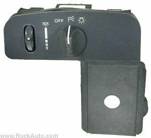

I dont have DRL and I have lights only when i turn the highbeams on. I do have parking lights in the P and Headlight position

Ok so what I need you to do is check the switch to see if it is working. You will need a digital multi meter for this test and some others. There is a yellow wire that comes out of the headlight switch make sure it has battery voltage when you turn the headlight switch on. If this is good then you need to check the headlight dimmer switch this is what switches for high to low beam. Now there is a tan wire that comes out of that and goes to the headlights so you can unplug a headlight and check the tan wire there and switch from low to high and back and check what the voltage is in the low beam possition. If there voltage isn't there at times but is alway's at the yellow wire then the headlight dimmer switch is the problem. Let me know how it goes.

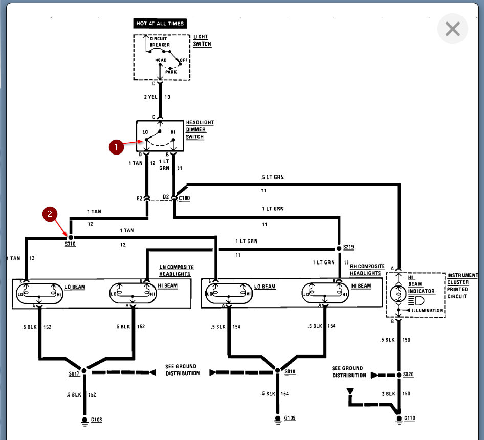

JOHN MORRIS2
No head lights. High beams and everything thing else is working fine.
Sep 25, 2020 at 2:40 AM (Merged)
The fact that the high beams work means this is one of two things. The head lamp switch or the wiring going to the splice. As you can see from the wiring diagram the low beams share everything until you get to the splice that I pointed out (number 2). Before that, they are run on the same circuit and clearly the switch is the same for both. So we need to go to that splice or the C100 connector and check for power on the Tan wire when the low beams are turned on. If there is no power, check it coming out of the switch. If nothing, put a switch in it.
Let us know what you find and we can go from there. Thanks

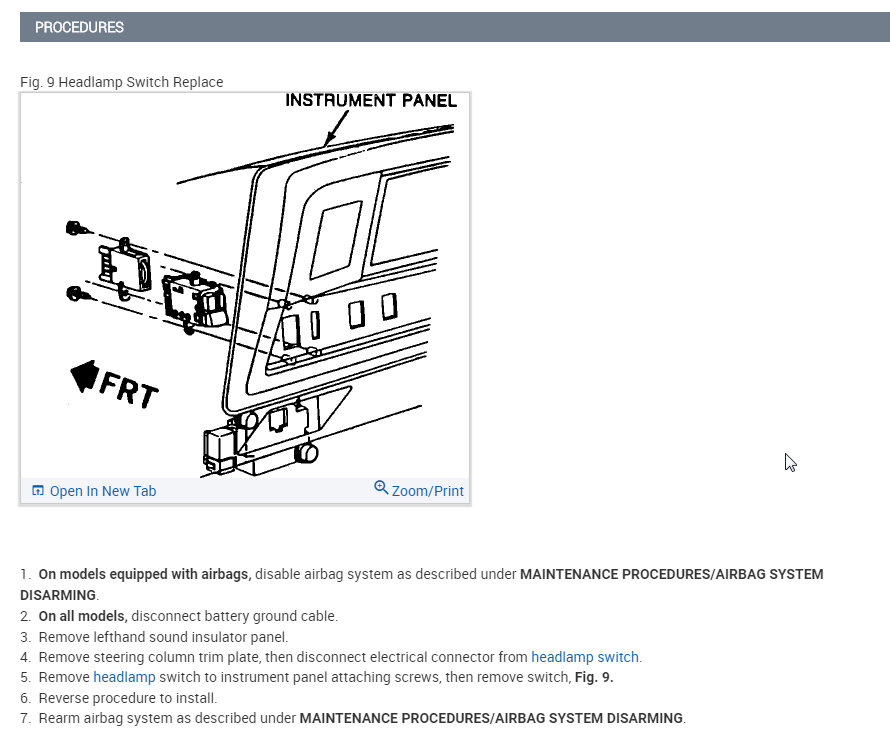

How do I replace the headlight switch?
I attached the process from the manual on how to replace it. Let me know if you need more info. Thanks
