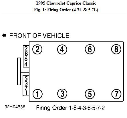

I am trying to install an opti distributor ono a 1995 caprice sedan used police cruiser. Ithere are three slots on the back of the cap housing and I dont know which slot is the correct slot although one slot has an indent towords the top of the slot. I have tried all three ways with negative affects. I have also replaced the plug wires which leaves a possibility that one or two may have been crossed. I don't know the proper location for each plug on the cap to tell if one did get crossed. So I'm stuck with which slot on the cap aligns with the cam pin and which wire goes where on the cap itself, please help and thank you, Darren

Thank you for the response however the opti cap does not specify wich plug goes where. Had the been a regular distributor your answer would be more than efficient. I can manage the tdc and the engines firing order but I can't manage the plug placement on the cap itself.

THIS IS MIKE
  • 686 POSTS
We do our best to help everyone we can. Contact Opti to find out the order on the cap, we don't have that information. Here is the firing order for both the 4.3L and the 5.7L in case your wires have been crossed during the installation.
