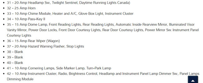

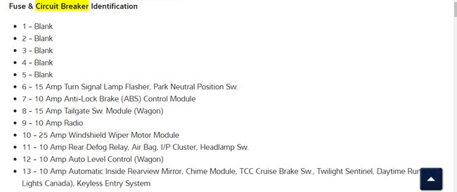

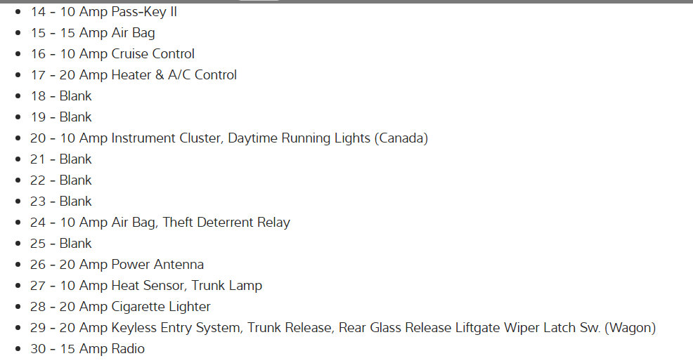

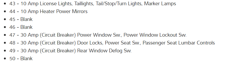

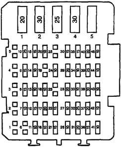

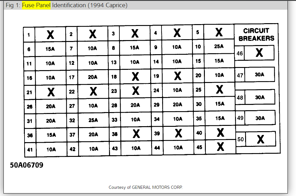

Hi, I need a fuse box for the car listed above and an abbreviation! Thank you
Aug 11, 2019 at 7:43 AM
SCGRANTURISMO
  • 4,897 POSTS
I have included for you in the diagrams down below the information that you have requested. I have included the fuse panel diagram and callout for your vehicle. Please go through these diagrams and get back to us with what you are able to find.
Thanks,
Alex
2CarPros
