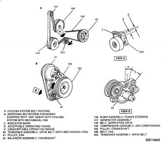

Hi im trying to put the belt back on but its just not going back on and I already put the water pump back on is there any other way i can loosen something for me to put the belt back on

Hi Guessing you didn't release belt tensioner to remove belt. Have diagram of two types used it maybe a little small but can print and enlarge.Tensioners are spring loaded so you crank it put belt on release and belt is adjusted. Hope this helps Thanks for donate
