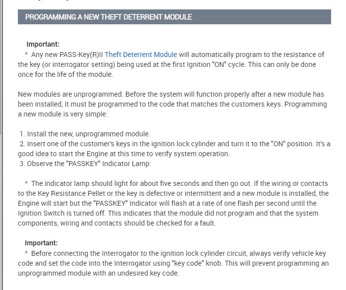

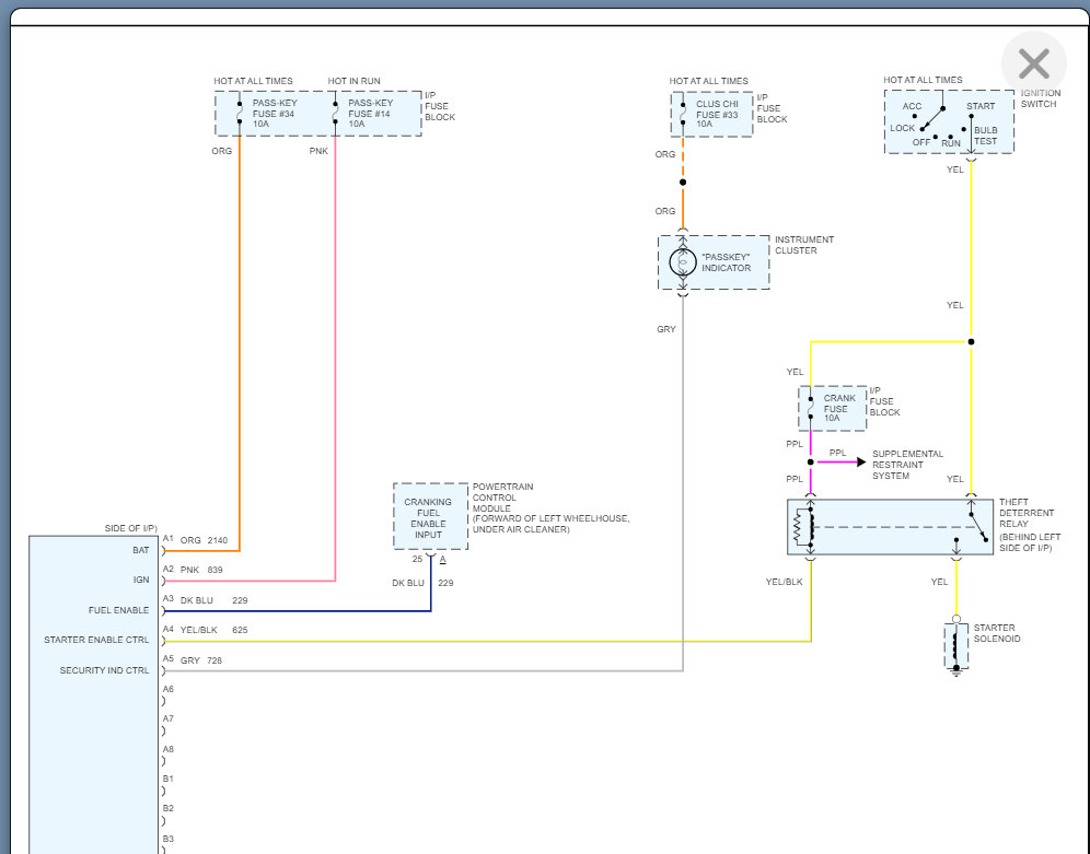

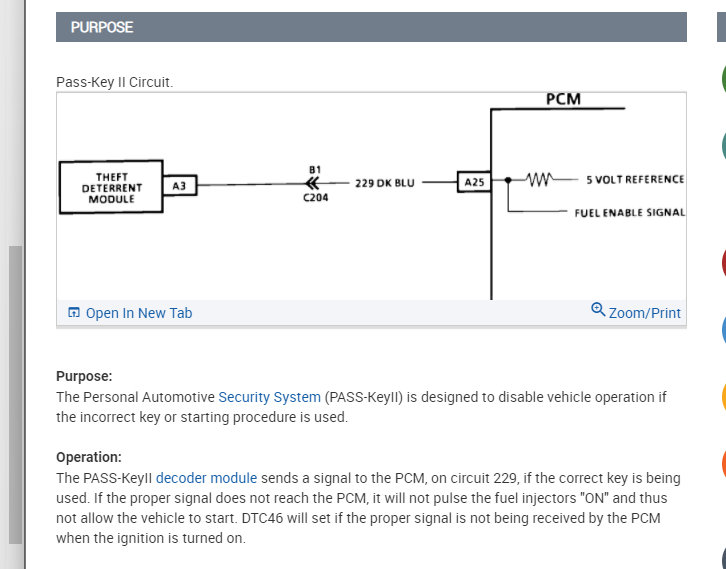

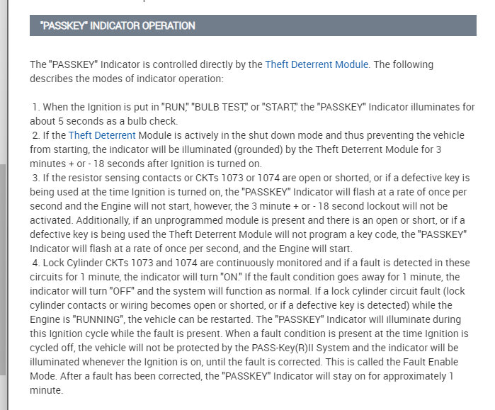

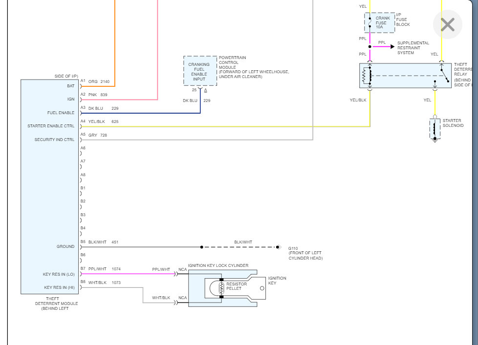

I am attaching the info below on this system including the wiring diagram that will help with any testing that needs to be done.
Please run through this and let me know what questions you have.
