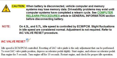

Dear Sir,
I have changed the 8 plug wires for my car and after that the IDLE speed becomes too high. I kindly request you please let me know how to adjust it. I also requesting you please let me that, where can I buy repairing manual for Chevrolet_ Caprice_1994_4.3L_Automatic_2 wheel drive.

Hi there, Thank you for the donation, See text for idle re set, check the blue link at the button of your question for work shop manuals. Mark (mhpautos)
