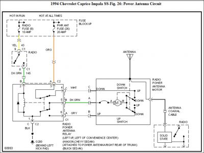

My electric antenna only makes a noise for an instant and it will not go up or down, how do I remove it for repair or replacement

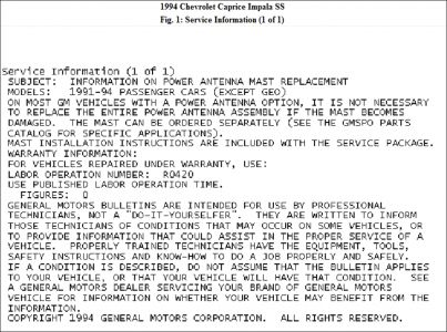

Most likely on your model, remove the right front tire and the inside fender well. The power antenna is located behind that. Make sure you also unscrew the nut on top of the fender that the mast runs through. Also, I did find a service bulleting on your vehicle.....it is below......... EXPERTEC TSB TECHNICAL SERVICE BULLETIN Reference Number(s): 439604, Date of Issue: 04/07/94 Related Ref Number(s): 439604 ARTICLE BEGINNING INFORMATION ON POWER ANTENNA MAST REPLACEMENT Chevrolet 439604 Pontiac 439604 Oldsmobile 439604 Buick 439604 Cadillac 439604 04/07/1994 Fig. 1: Service Information (1 of 1)
https://images.2carpros.com/forum/automotive_pictures/248015_F1_2.jpg

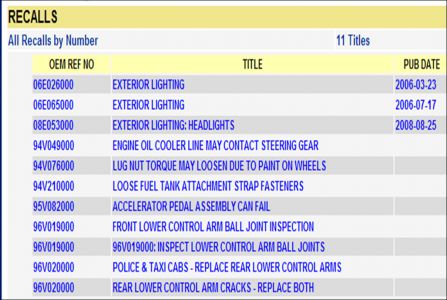

Last, it looks like you may have some recalls on your vehicle. The dealer may fix these for free. Please contact the dealer service department, give them the VIN number of your car and have them check on these to see if they apply to you.
https://images.2carpros.com/forum/automotive_pictures/248015_Recalls_6.jpg
