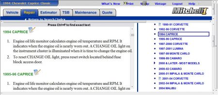

Wal-mart changed my oil, but forgot to turn on or re-set the "Change Oil" warning light on my dash. How do I do it, or does a repair man have to do it? Thanks.

Here you go
https://images.2carpros.com/forum/automotive_pictures/12900_oil_6.jpg
