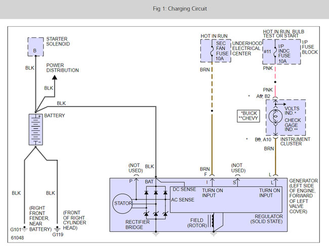

i have an 94 caprice an the old pig tail that had 2 brown wires broke now the new pig tail i have has 3 so what i want to know is what do the wires go too there are 2 regular size wires an one thick one on the new pigtail so could u please tell me how to hook this up the 2 brown wires that are left from the old is not marks in any kind of way so i dont know which wire goes to what thanks in advance
if u have pics or detail diagram i would really love that

Here is the wiring diagrams for the charging circuit and alternator. Check out the diagrams (Below). Please let us know if you need anything else to get the problem fixed.
Cheers
