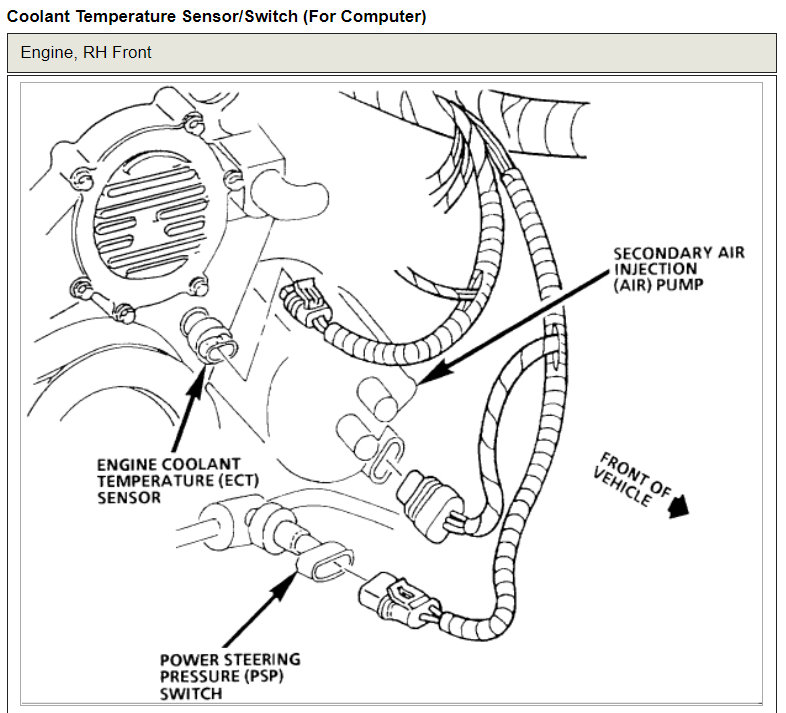

Temperature gauge does not move.

It sounds like the engine coolant temperature sensor is not working. Here is a guide to help you change it out and the location for your car in the diagrams below:
https://www.2carpros.com/articles/coolant-temperature-sensor-cts-replacement
Cheers

Thanks! All fixed. :)
