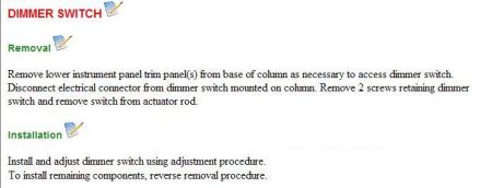

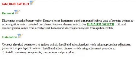

https://images.2carpros.com/forum/automotive_pictures/261618_Noname_1758.jpg
https://images.2carpros.com/forum/automotive_pictures/261618_Noname2_553.jpg
