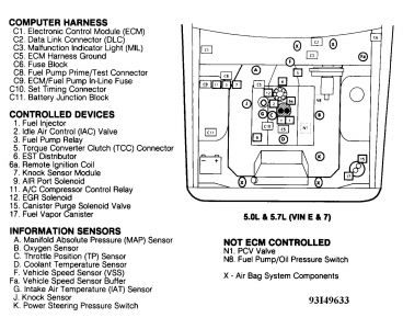

1993 Chevy Caprice Two Wheel Drive Automatic 120000 miles
its like its not getting fuel to the throttle body but i checked the fuel pump and fuel fliter both are working and clean the battery died but i charged it so i honestly have no clue what to do

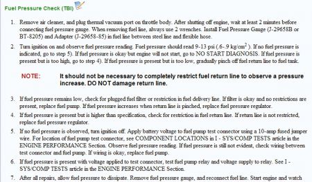

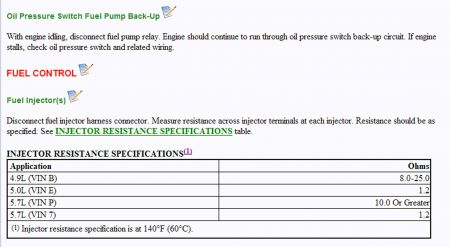

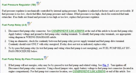

Try these test, You should really pressure test the pump!
https://images.2carpros.com/forum/automotive_pictures/62217_Tests_1.jpg
https://images.2carpros.com/forum/automotive_pictures/62217_Testing_3.jpg
https://images.2carpros.com/forum/automotive_pictures/62217_50571_1.jpg
https://images.2carpros.com/forum/automotive_pictures/62217_Resistance_1.jpg
