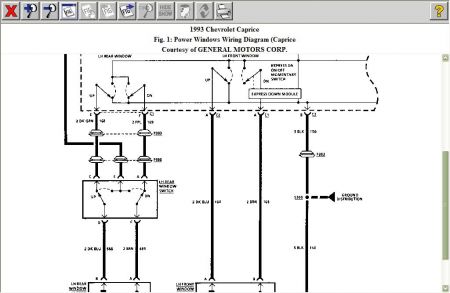

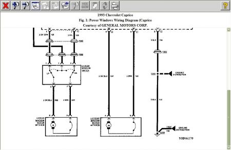

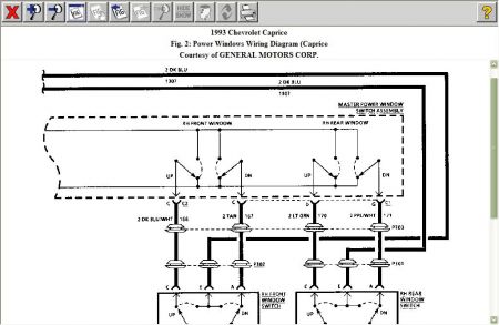

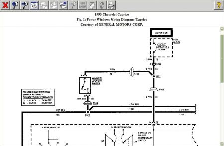

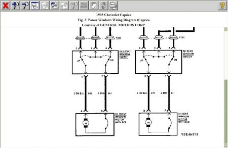

1993 Chevy Caprice V8 Two Wheel Drive Automatic
wire diagram for power window

There you go see below
