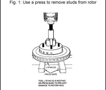

1992 Chevy Caprice Two Wheel Drive Automatic
how do you replace the studs that hold the lug nut on

They should press out. You might be able to use a large C clamp?
https://images.2carpros.com/forum/automotive_pictures/170934_wheel_lug_stud_1.jpg
