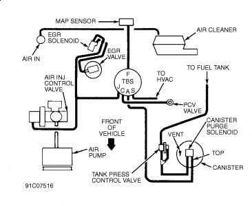

LOOKING FOR A DIAGRAM FOR ALL LINES. SOME ARE HOOKED UP WRONG OTHERS NOT AT ALL

This help
https://images.2carpros.com/forum/automotive_pictures/198357_Graphic_431.jpg
