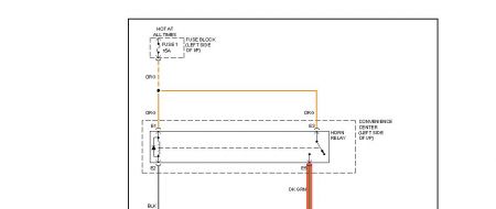

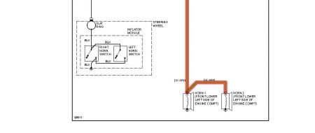

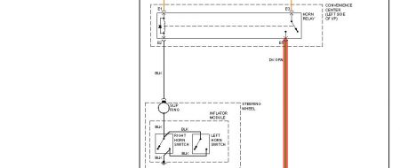

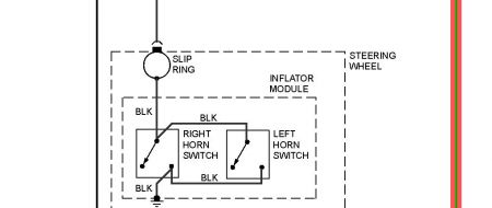

wife took her car today for state inspection, failed because mechanic could not get horn to work. I have no problem with it when I drive, there are two spots at the bottom of the wheel showing a hor, press hard-voila-Is there any thing I can do to make it easier? Thanks
Jun 3, 2008 at 10:24 AM
  • 75,988 POSTS
Inspect the fuse no.1 15amp and Clean the ground side of the horn. Find the horn relay in the convenience center and test it-also see below circuitry
