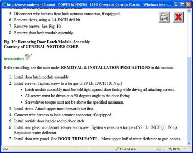

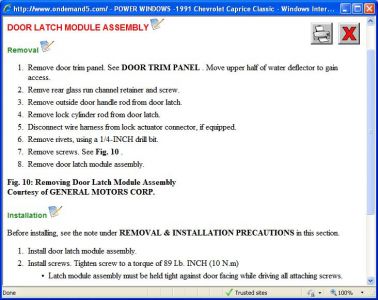

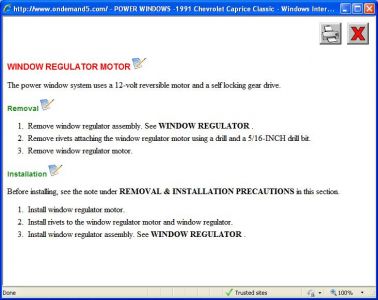

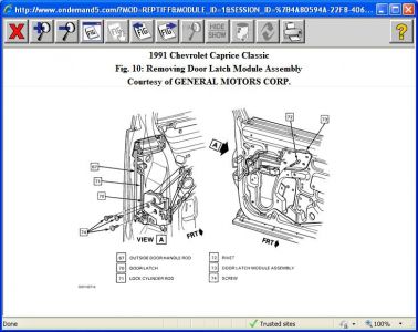

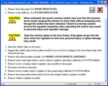

HI , how do you install a drivers side power windows motor iv allready got the new motor and taken the door panal off
Jul 30, 2010 at 2:26 PM
SATURNTECH9
  • 30,869 POSTS
https://images.2carpros.com/forum/automotive_pictures/416332_1991_chevy_caprice_window_motor_part1_1.jpg
https://images.2carpros.com/forum/automotive_pictures/416332_1991_chevy_caprice_window_motor_part2_1.jpg
https://images.2carpros.com/forum/automotive_pictures/416332_1991_chevy_caprice_window_motor_part3_1.jpg
https://images.2carpros.com/forum/automotive_pictures/416332_1991_chevy_caprice_window_motor_part4_1.jpg
https://images.2carpros.com/forum/automotive_pictures/416332_1991_chevy_caprice_window_motor_part5_1.jpg
There you go.
