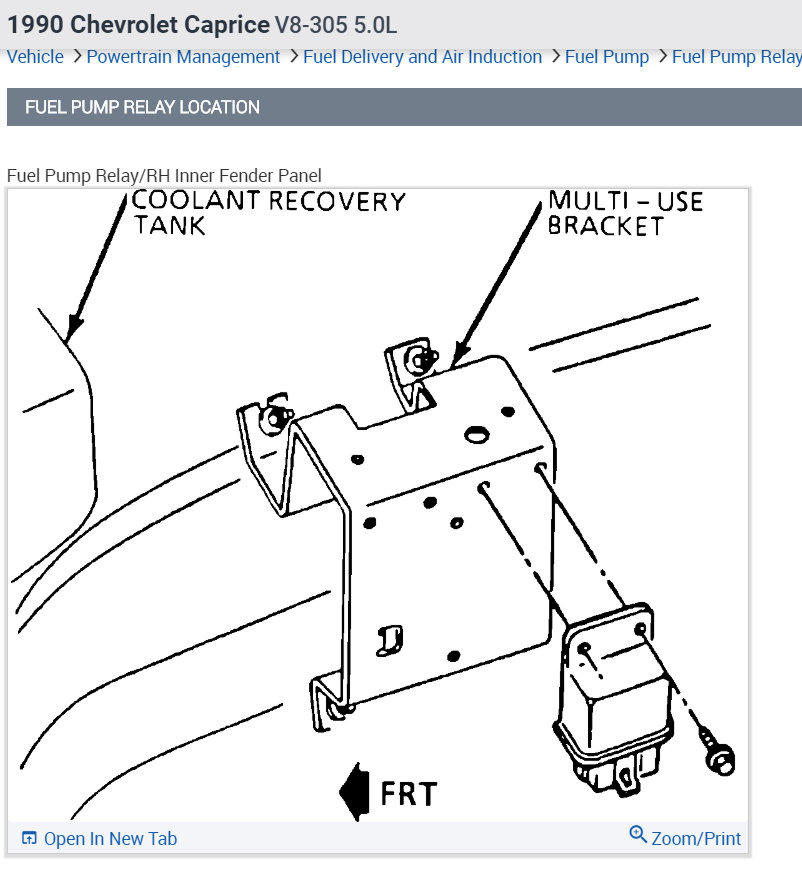

someone help! i have changed the fuel pump the fuse in my 90 caprice it is fuel injected with a two barrel and the pump still will not come on i bypass the relay and it works but the injectors will not keep it running i changed the relay,pump and fuse and that wasn't it either and i missing?

Check for spark if none then injectors will not spray. Here is a guide to help test the fuel pump relay with the location in the diagrams below.

how can i hard wire a fuel pump.? i tried wiring it to hot wire was getting gas to carb but it would not come out of injectors.if i jumped the relay would it work??? any help would be appreciated....

Stay in your original post -your problem here could be power to injectors/there's no input signal from a sensor telling the computer to snchronize the injector/s or the computer itself

well your right . i have tried everything. i dont know what to check to make sure the injectors are gettn power..like i said i wired the pump directly to hot to see if it would work it did but no gas out of injectors..what do you suggest i do now to resolve this?? i want to do it the right way.
