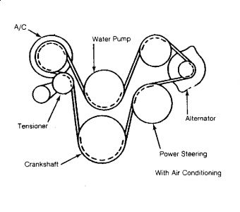

Is this belt routing?
https://images.2carpros.com/forum/automotive_pictures/198357_Grafic_3_91.jpg
If yes tensioner is weak
