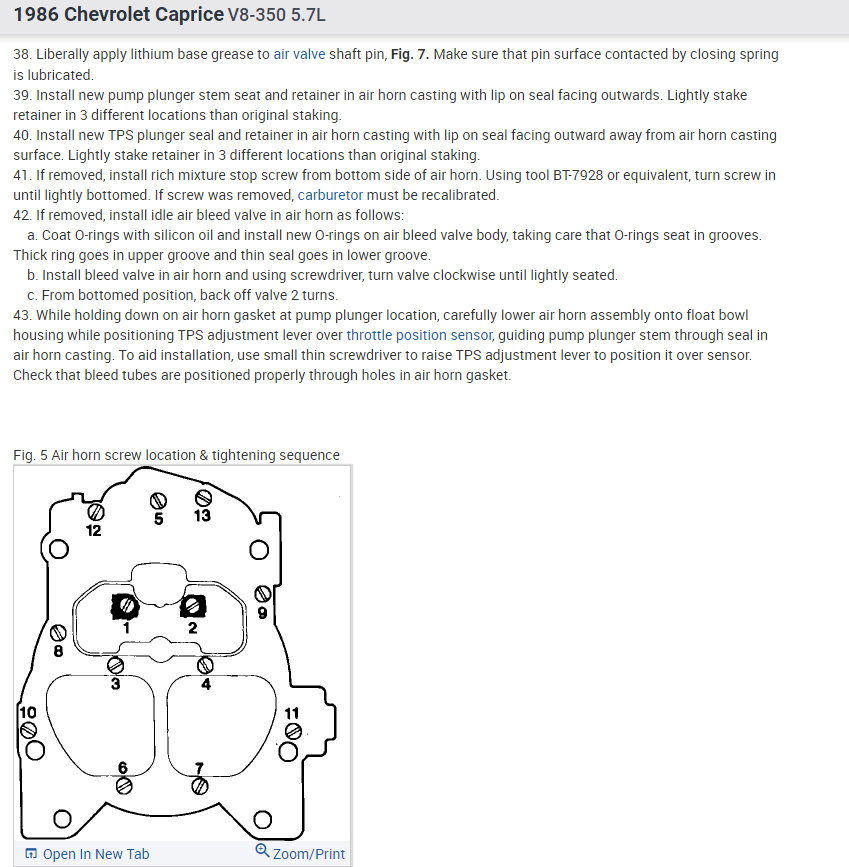

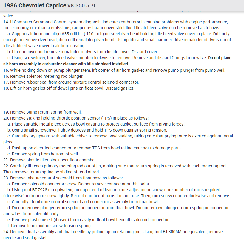

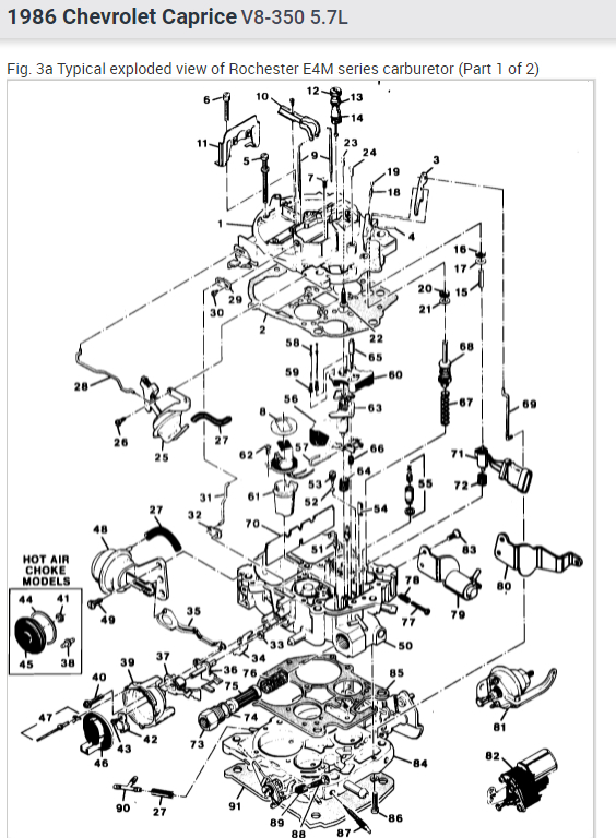

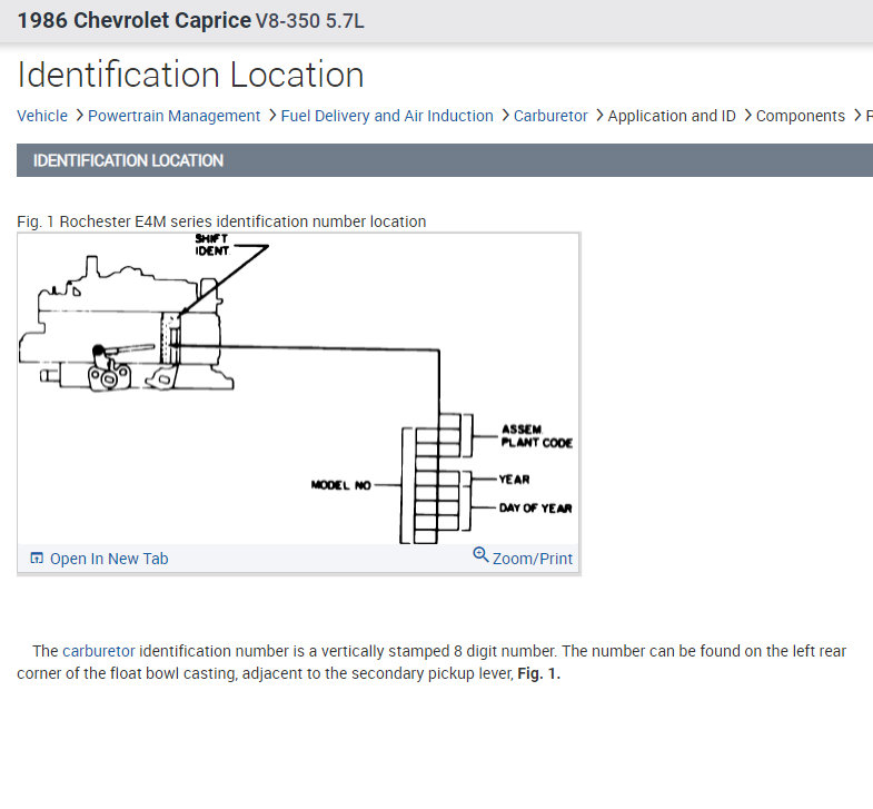

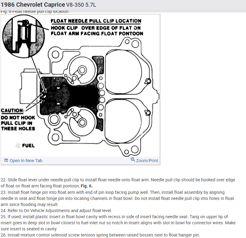

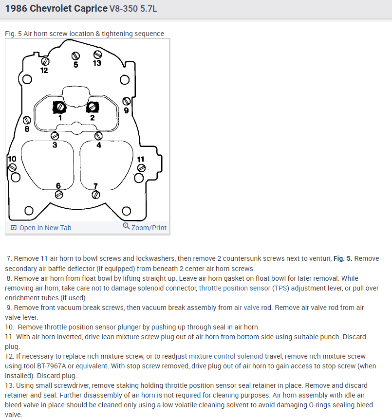

i need to know how to replace my carburetor?
Sep 17, 2009 at 2:02 PM
SQM
  • 6,383 POSTS

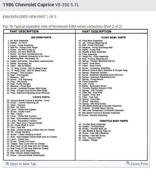

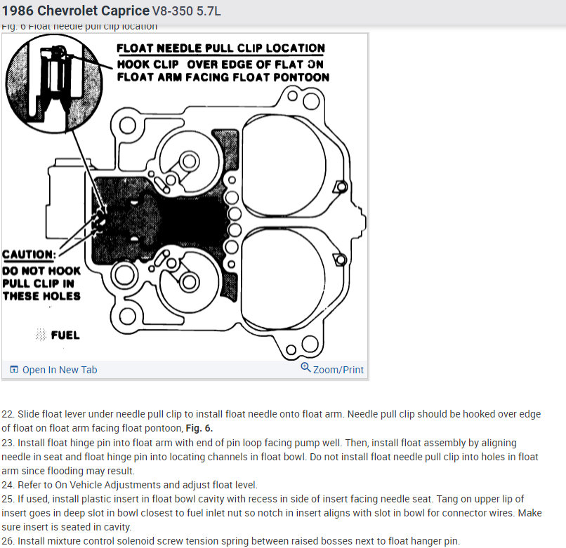

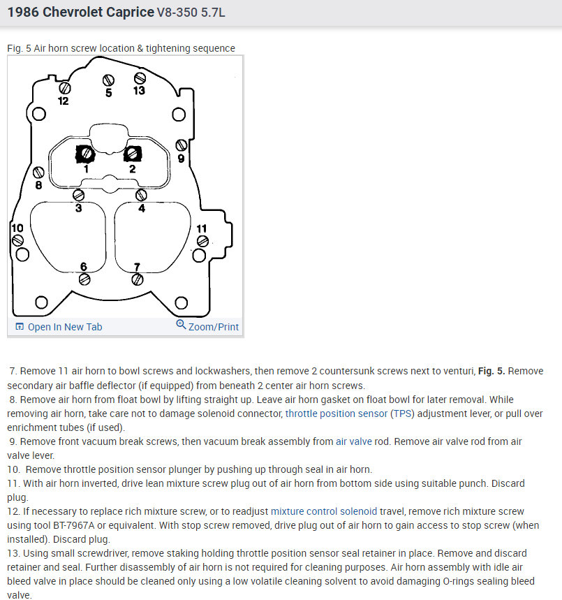

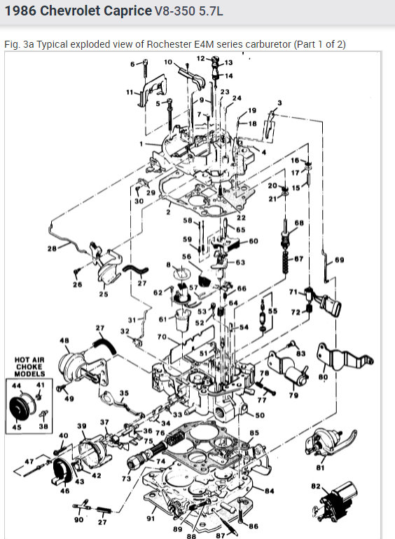

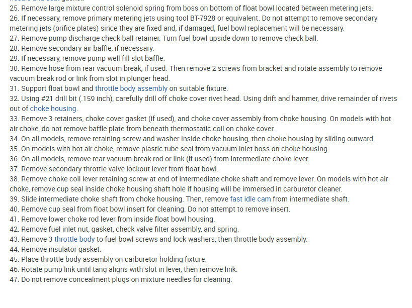

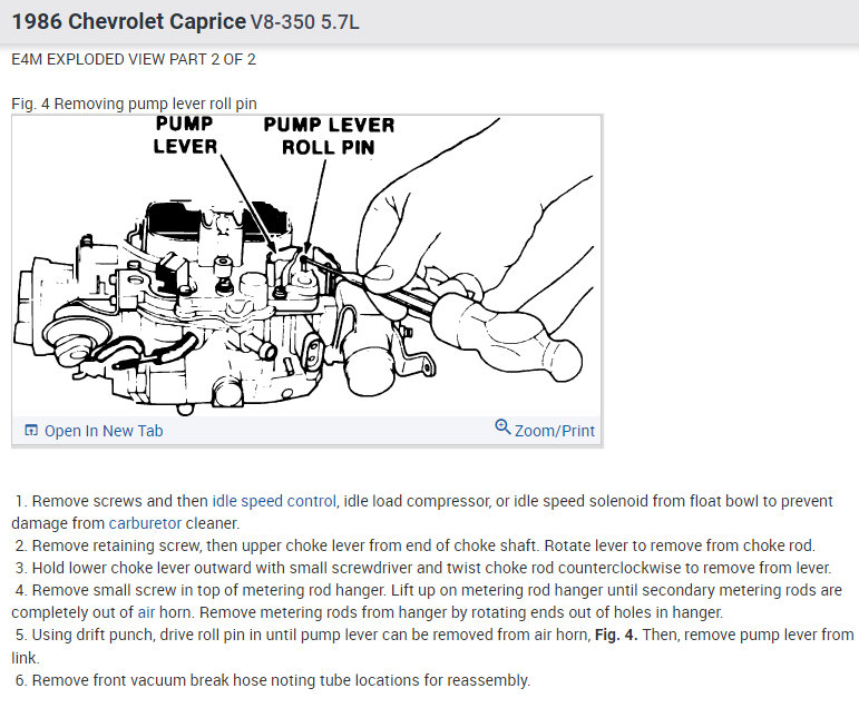

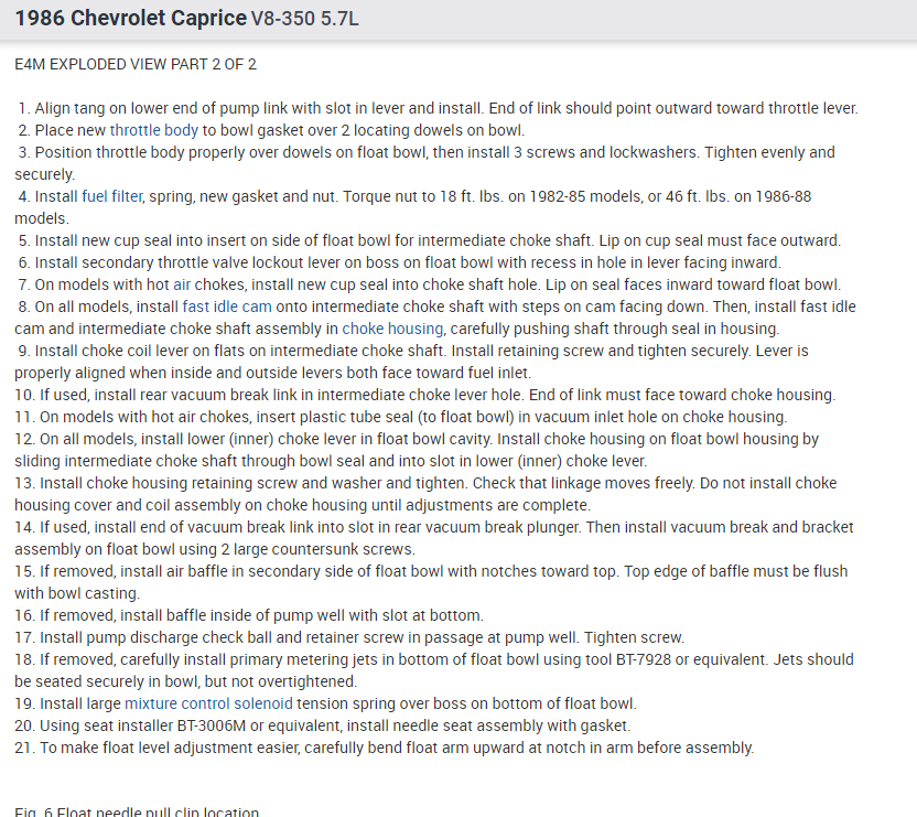

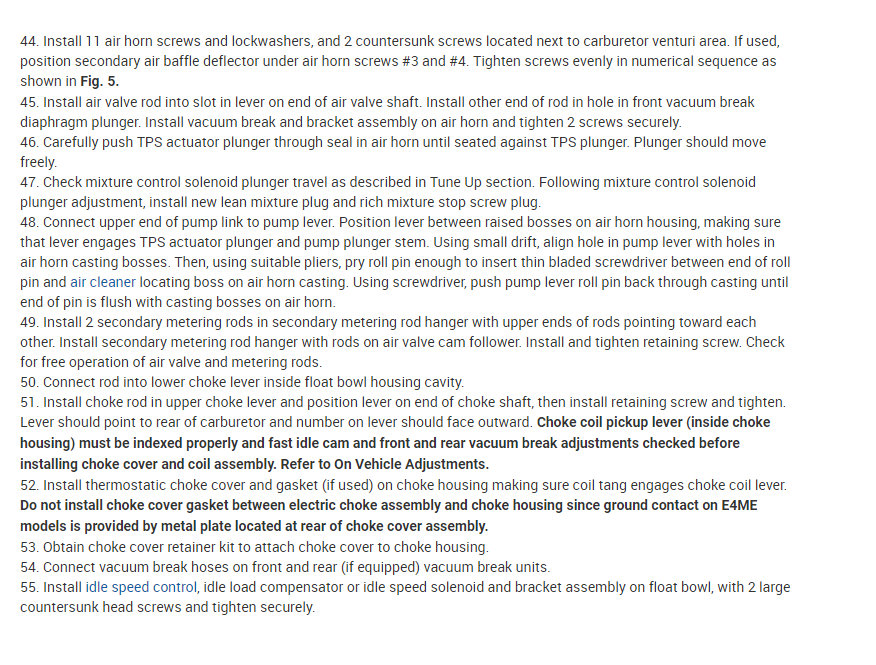

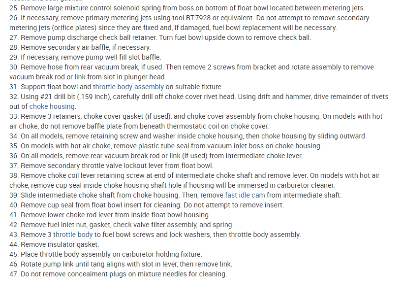

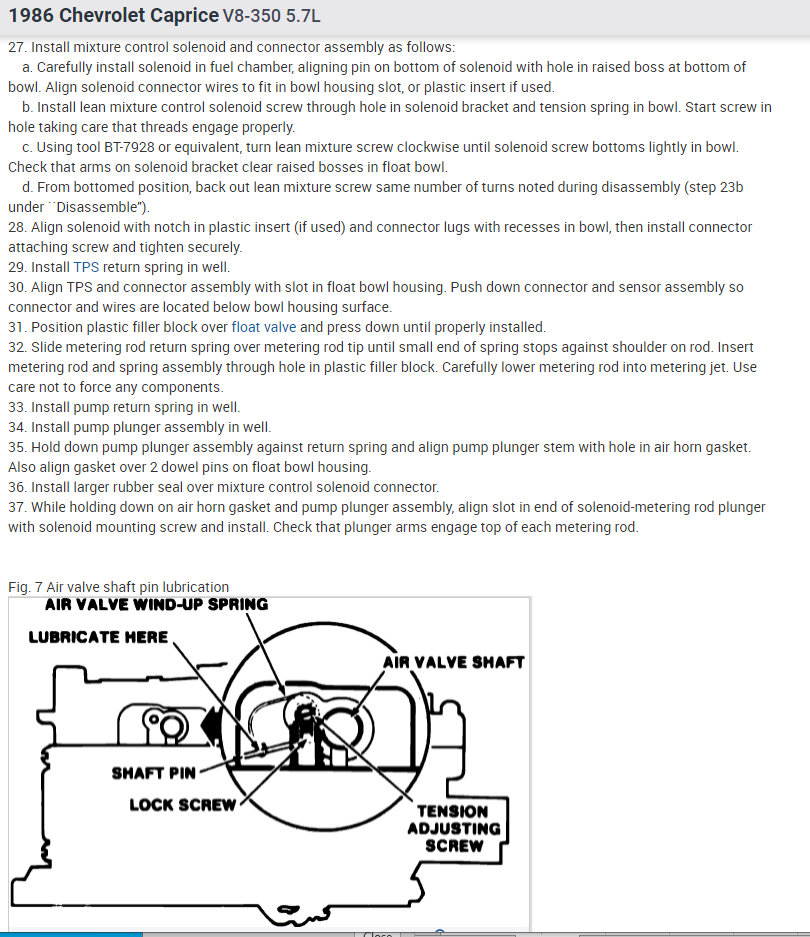

To remove the carburetor first you will have to get the air filter and housing out.
Then remover the fuel line using a line wrench.
The detach the linkage from the carburetor.
Then remove the mounting bolt to take it out.
I have included the carburetor disassembly and re assembly procedure below.
Please let me now of any questions.
