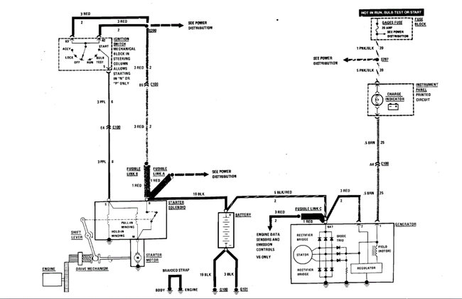

i am trying to install a car alarm with an auto start system but i need a wire diagram for my 1984 chevy caprice. can you provide me with a wiring diagram.

Because of the model year, the schematics are a little basic. What I was able to find that I thought would help is the schematic for the starting/charging system. I attached the pic below.
When installing this, take your time. Make sure that all wiring you connect to is properly reconnected and insulated to prevent shorts.
Also, here is a link you may find helpful. It explains how to test wiring.
See pic below.
