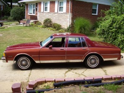

I have an 82 Caprice. The speedo and cruise control had stopped working a few years ago, so I had brought it to the dealer for repair. The mechanic said the cruise control transducer was bad, and they didn't make that part anymore. He put on a new speedo cable, bypassing the cruise control (I don't know if he removed the old transducer -- I don't even know what a transducer looks like.) But I'm tired of not having a working cruise control, so I'd like to get it fixed. Does anyone know where I could buy a cruise control transducer, either new or remanufactured, for this particular year, make, and model?
[img:0fa9ea0372]http://www.2carpros.com/forum/automotive_pictures/213175_P7210006small_1.jpg[/img:0fa9ea0372]

NICE LOOKING CAR...
