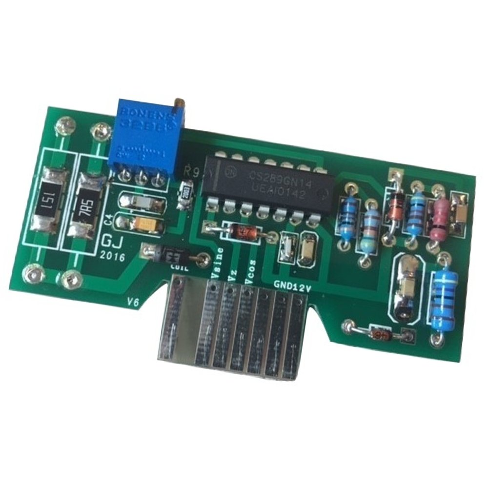

Hi there my Tach reads about 5000 rpm at idle, I have checked the wiring as per the factory manual.
All the circuits checkout okay ,I have replaced the Tach as recommended by the manual but the new one does the same thing ,where do I look next?

exchang out your curcuit board as this is usually the problem, i had the same problem and it cured it

I had the same problem with the tach on my 92 Camaro. Tried the resistor fix but it didnt work. Finally found a tach board at the junkyard that worked for about a year.
I found a new replacement tach board. Only had it for about a week but it seemed to fix the problem! Hurray!!

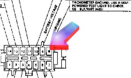

I have a 91 camaro V8 RS convertible...the tach maxes out & stays there when the car is running...any ideas on the fix?

Sounds like a ground problem with the gauge.

isn't the whole instrument cluster grounded as a unit....if not any ideas on where the tach is grounded

the gauges are not all grounded together. Here is the location of the ground on the connector for the tach.

Check the tachometer ground at the instrument cluster connector, since the gauges are not all grounded together. If the ground and wiring are good, replace the tach circuit board, which several owners reported fixed a high or pegged tach reading.
