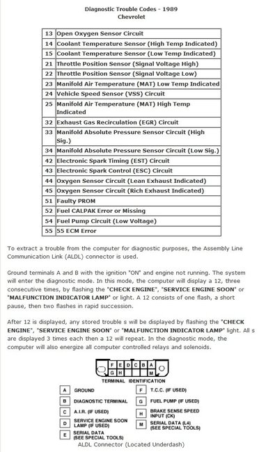

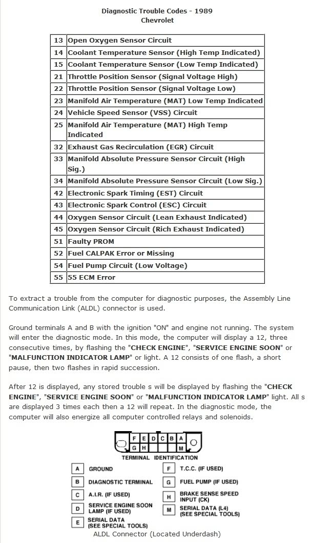

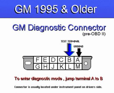

Jumper A to B on the ALCL and count the flashes example DTC 12 Flash pause then flash flash it will show two more times before it goes to the next code if any

Chevrolet
13 Open Oxygen Sensor Circuit
14 Coolant Temperature Sensor (High Temp Indicated)
15 Coolant Temperature Sensor (Low Temp Indicated)
21 Throttle Position Sensor (Signal Voltage High)
22 Throttle Position Sensor (Signal Voltage Low)
23 Manifold Air Temperature (MAT) Low Temp Indicated
24 Vehicle Speed Sensor (VSS) Circuit
25 Manifold Air Temperature (MAT) High Temp Indicated
32 Exhaust Gas Recirculation (EGR) Circuit
33 Manifold Absolute Pressure Sensor Circuit (High Sig.)
34 Manifold Absolute Pressure Sensor Circuit (Low Sig.)
35 Idle Air Control (IAC)
41 Cylinder Select Error
42 Ignition Control (IC) Circuit
43 Knock Sensor (KS) Circuit
44 Oxygen Sensor Circuit (Lean Exhaust Indicated)
45 Oxygen Sensor Circuit (Rich Exhaust Indicated)
51 EEPROM or ECM Failure
53 System Voltage Overcharge
54 Fuel Pump Circuit (Low Voltage)
55 ECM Error
61 Degraded Oxygen Sensor
62 Transaxle Gear Switch Signal Circuit
63 A/C Refrigerant Pressure Sensor Circuit

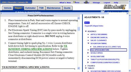

Start by checking the fuel pressure-if its okay-check the ignition timing should be 0/TDC follow procedures below and also recheck the IACV and TPS Also check the EGR and PCV valves
https://images.2carpros.com/forum/automotive_pictures/12900_est_2.jpg
Here's how to clean the IAC valve: Disconnect the air intake ductwork from the throttle body. Start the engine, then increase and hold the idle speed to 1,000 to 1,500 rpm. Spray the throttle cleaner or engine cleaner into the throat of the throttle body, aiming for the idle air bypass port (usually located on the side or top of the throttle body opening). Give this area a good dose of cleaner (about 10 second's worth). Turn the engine off to allow the cleaner to soak into the IAC passageway. Wait about three minutes. Restart the engine, rev and hold at 1,000 to 1,500 rpm, and repeat the cleaning process again. Turn the engine off again, and reattach the air intake ductwork to the throttle body. Start the engine and rev and hold to 1,500 to 2,000 rpm until no white smoke is coming out of the exhaust pipe

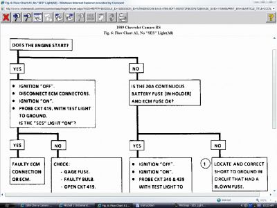

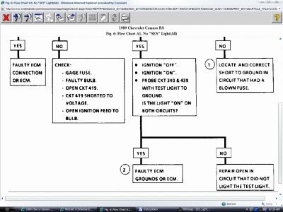

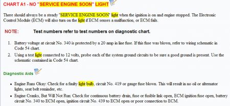

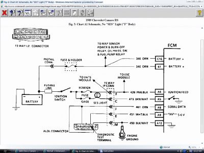

I have 89 camaro whats the next step if the service light dont worrk and checked the bulb it works?
Sep 24, 2019 at 12:23 PM (Merged)
MERLIN2021
  • 17,250 POSTS
Usually turns out to be a bad fuse, or connection...
https://images.2carpros.com/forum/automotive_pictures/62217_SES_Lighta_1.jpg
https://images.2carpros.com/forum/automotive_pictures/62217_SES_Lightb_1.jpg
https://images.2carpros.com/forum/automotive_pictures/62217_SES_Lightc_1.jpg
https://images.2carpros.com/forum/automotive_pictures/62217_SES_Lightd_1.jpg
