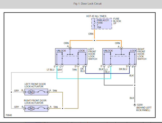

1994 Chevy Camaro Z28 92,000 miles. My power door locks don't work. I have replaced the switches and it still doesn't work. All fuses seem to be fine. Where is the relay for the power door locks?What could be the problem?

It sounds like you are losing power somewhere or both lock actuators have gone bad but to be sure follow this guide.
Here is a wiring diagram below
make sure pwr accy fuse 7 is good, check g200 connection behind the drivers kick panel, its a stud with 2 wires. Check for power at terminal A of the right hand door lock switch(with test light)to verify that there is power getting to the switches at least.

Yep my fuse was melted like the door lock switch or actuator is pulling too much but I found out it was caused by a bad connection. So i cleaned the fuse connectors up and everything is good now.
