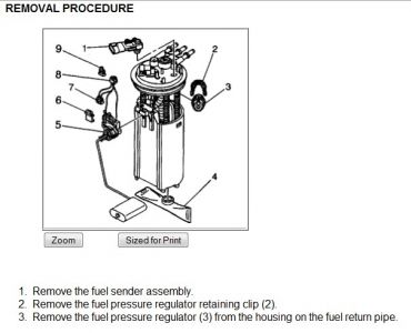

I talked to the parts man at the chevy dealer an he told me to get the fuel pressure regulator you have to buy the whole fuel rail .it not in the fuel tank. I am very disapointed with that answer. I would like my money back if that is all you can tell me.
Oct 12, 2010 at 12:54 PM
WRENCHTECH
  • 20,761 POSTS
Tell him to go check again It's #3 in the picture but is not your problem.
