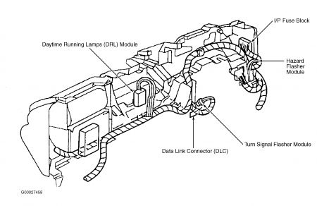

Where is the electronic flasher located in the 02 Camaro?
I've already taken the face plate off, under the steering wheel.
Tuesday, September 28th, 2010 AT 3:49 PM
BLUELIGHTNIN6
MECHANIC
16,542 POSTS
Turn signal flasher module is behind the dash, to the right of the steering column
