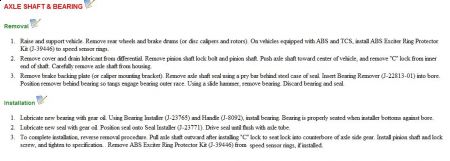

please tell me how to change the right rear wheel bearing. especially how to remove the axel. thanks

https://images.2carpros.com/forum/automotive_pictures/261618_1_145.jpg
